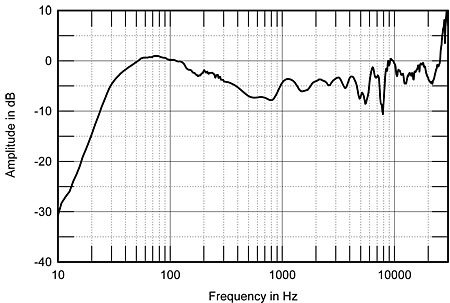

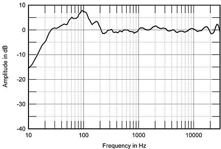

Those on axis Frequency Response plots are of limited use. There is not a direct correlation between what you hear in room vs a tiny slice of the entire response. You can't predict the in-room balance looking at just the on-axis.
On axis vs in room 1/6 octave averaged same speaker.
Rob :)
