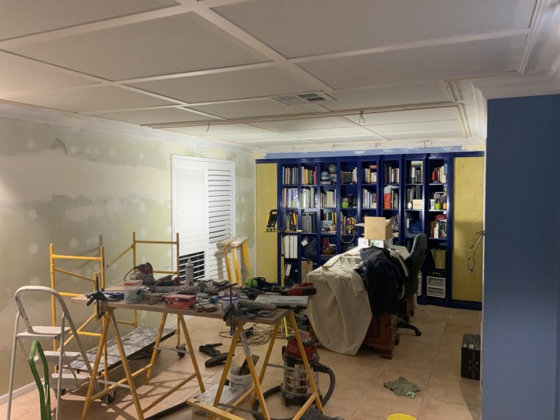

Room is down to the final steps of painting.
Will be interesting to learn how the new room sounds...presumably your soundchek plasterboard is a kind of room treatment?
Soundchek is high density sound orientated plasterboard (drywall). Two 13mm layers with greenglue in between have been added over the existing 10mm standard plasterboard with all gaps filled with acoustic sealant. This will help stop the walls rattling. Plus all lights and switches and PowerPoints are now surface mounted. Standards down lights use to sing along at high volumes.
Sorry had the wrong plasterboard name. It’s Soundstop by Knauf
Great stuff! Will definitely keep that name in mind for the future. Thanks and look forward to reading all about it!
