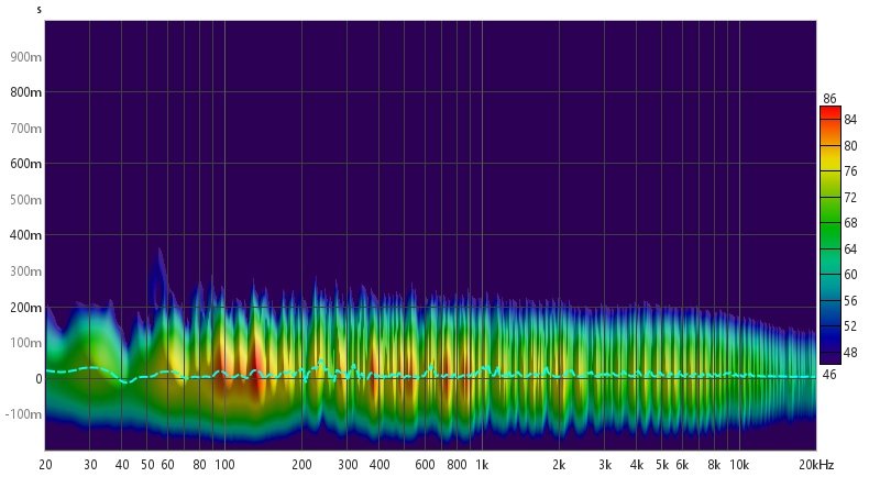

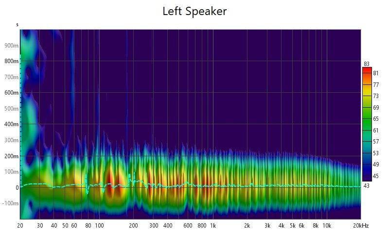

I did 3 new measurements with REW this evening... L speaker, R speaker and L+R together. These are the spectrogram captures. Are these helpful? I did new measurements because I've changed a couple of things since then?
If you don't mind me asking, does anything obvious jump out.
