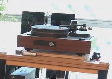

From video, the arm was probably a Stogi S 12 VTA (12") which has a 12g effective mass - so, alas, a bit different situation than the 18g EF 4P 11".
(The other VOX room featured the Monaco 2.0 turntable with the 4Point and a Fuuga cartridge.)
