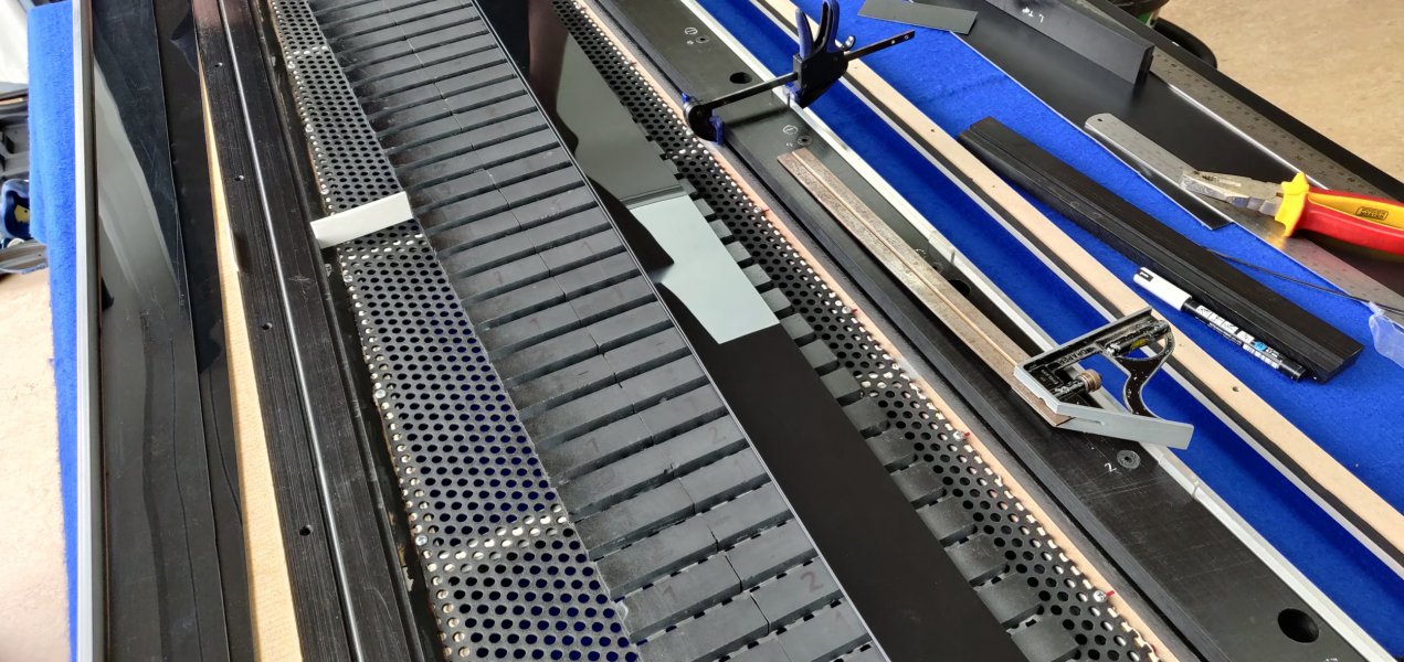

The actual driven area of the Duetta is equivalent to 6 12 inch bass drivers.Having replaced the bass ribbons on my Duettas myself I don`t recall the distance between the ribbon and magnets as being 7mm;more like 3mm unless your Interstellas are built differently than standard.BTW what type of MRT do the Interstellas have?
I installed the lightweight XLM2 versions,both these and the bass ribbons still going strong after 14 years,which is a testament to Grazs quality.
7mm was the figure the UK restorer told me.
Looking at them move with heavy bass tracks I believe it.
It's also in a fairly consistent ballpark with the Alsyvox magnet spacing of 1cm either side of the diaphragm I would say.
So I stand by my figure.
The bass ribbon magnet gap on my Duettas is definately not as large as 7mm so I would suspect your Interstellas have stronger magnets than standard.As I recall you had input into the rebuild of your speakers; do you remember if the magnets were upgraded?
Nope the only thing left that is original in the speakers are the magnet arrays.
However, all magnets were removed and more precisely aligned.
That shouldn't make any difference to the spacing, though.
I can see very large movements in the bass panel by putting nothing but 15Hz into the speaker from a signal generator. But be careful not to do that too loud.
I can double check with the restorer if it's important to you.
Surgery pic below LOL. IIRC correctly the bottom clamp is 18mm thick. You can't see the top clamp in that pic.
The more I think about the excursion figure the more I am wondering if I am remembering correctly. The bar magnet thickness I can't remember. Plus they are raised a tiny bit by the grid.
Don't rely on the pic to draw conclusions. It's deceptive.

Thanks for reply.From the picture it looks like the clamps are made from Corian in place of the original MDF;also I notice some horizontal bracing at the back of the magnet structure,interesting!
While I was tuning the bass panels I thought out of curiosity what the frequency response of these full range would be;the result was pretty flat out to 12khz and then fell away quite steeply.Try that with a cone woofer!
My Duettas are braced on the back both vertically and horizontaly and rigidly bolted via two stays to 45kg damped granite bases which isolate them from the wooden floor to good effect.They are actively driven by a crossover I built myself from a kit supplied by a local eccentric but brilliant electronic designer called Les Sage,sadly now passed on.
