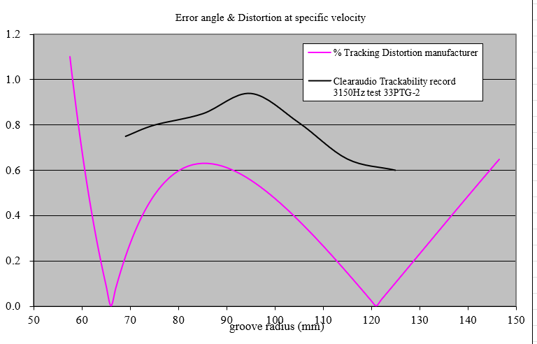

I think you’re mixing things up here. It seems like you’re trying to measure the time difference between channels, but you’re focusing on overhang. The time difference between channels is more closely related to azimuth than overhang. If you perfectly set the overhang on an SME V, the maximum error would be around 1.8 degrees. However, the measurements you’re discussing are more related to phase and azimuth. Of course, all adjustments are interrelated, and remember that high distortion can be caused by many factors beyond alignment.
I am not changing overhang or thinking about it, not intentionally. If the tracking angle error is X degrees should that not show up as time difference left-right channel since the cartridge sides are not 90degrees to the groove direction, and touching “different” spots , one channel before the other?
I have difficulty visualizing how different azimuth makes one channel movement occur before the other ,,,
PS The SME V mounting holes allows some rotation of the cartridge to change offset angle slightly.
Regarding the IEC and Baerwald alignment, on which the SME V tonearm is based, tracking error reaches its maximum of approximately 1.8 degrees at the outer and inner grooves, as well as between the null points. Elsewhere, the tracking error is below 1.8 degrees, and it reaches zero at the null points. You aim zeroing tracking error by aligning the zenith at the outer null point, approximately at a 120mm radius. However, even with precise overhang and zenith alignment, azimuth remains a critical factor. This is because stereo records employ the 45/45 Westrex cutting system, where both channels are encoded together and read in relation to each other. Any tilt in the coils alters this relationship, introducing a phase shift. A phase shift results in a timing difference between channels, affecting playback and, if present in the cutting stage, potentially compounding phase error.
Even with a mono record, using a stereo cartridge like the AT OC9 inherently introduces phase error if azimuth is not correctly set. Azimuth alignment impacts not only channel separation but also phase accuracy. This insight also addresses your previous questions on azimuth topics: channel separation is just one aspect of azimuth alignment, with phase alignment being equally essential. BTW apart from calculations you made, this response is about measurements and matching calculations with measurements which I assume you're after.

I can’t say with certainty which method is best, but in my opinion, AM is a solid choice for aligning zenith since it uses a dynamic approach with test records. Alternatively, sending the cartridge to Wally Tools for inspection and alignment with their proprietary zenith protractor offers a static alternative.
And Analog Magic uses a 2 tone lateral modulated track and calculates Intermodulation distortion?
It’s not disclosed how AM does the calculation. At least I’m not aware of any.
