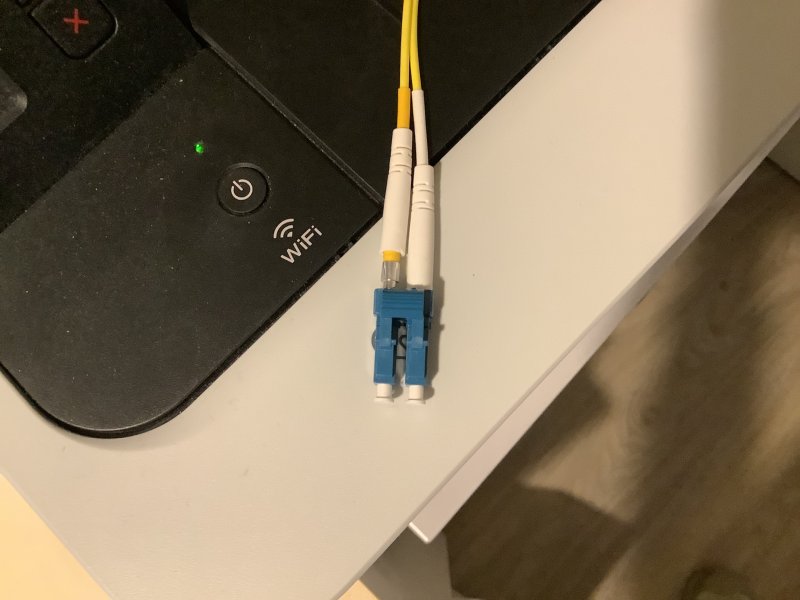

On ONE end try reversing the two connectors of the cable. You can remove them from the plastic clip to test.
No way I can separate the 2 fibers from the plastic clip. Each fiber is crimped metal to metal ferrule.
Not separate the fiber, remove the connector from the plastic clip that is holding them side by side. You can do it. To be clear you’re not doing anything to the cable or fiber, only removing from the holding clip.

Ok, put it back the way it was then. I would find it hard to believe you have two bad SFP. It’s not common for them to go bad.
