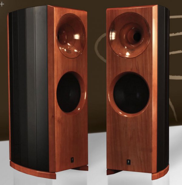

Never heard of them until now. The Client EVO 3.18 struggles with my aesthetic. No doubt they deserve coverage from someone other than Serinus who seems weirder everytime I read him. The woodwork looks very nice. How well would something like that hold up over time? I've had some sketchy experience with curvy wood components.
The Symphonia certainly looks interesting, though likely ot of my price range.
I wonder what they sound like?
I think they are poor. Colored mids and wooly midbass

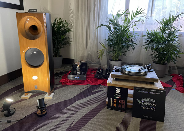

The model below this one is more conventional looking...
Expected nothing less from you Ked ... ;0}
Very well indeed...
I had Client EVO 1.5 Reference in Wenge finish for a while ( not my image ) whilst looking after them for a friend, lovely speakers.
Seems you and Ked don't agree...who would've thought... I haven't heard these but from the components and design they seem promising...if you don't want horns but with a more conventional bass alignment...

Something of a compromise over full range horn loading for sure however a fine sounding compromise for conventional domicile rooms
