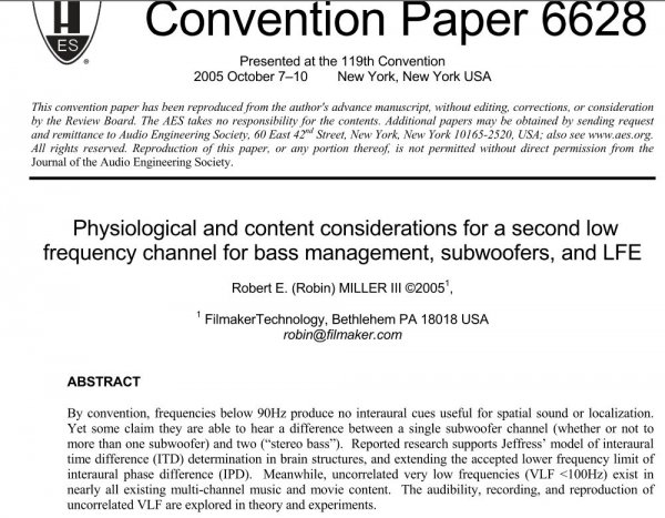

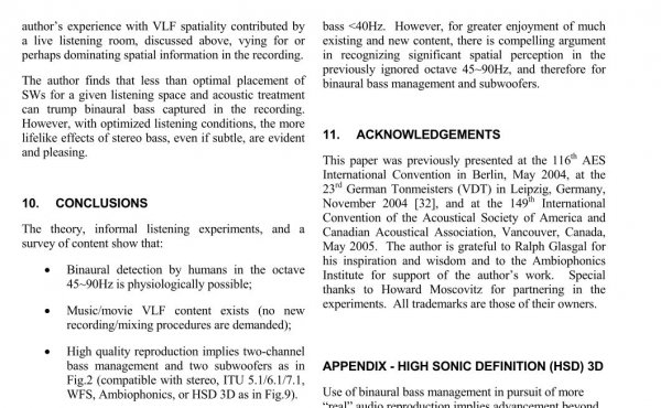

Just to show things are not so clear as you seem to think, I am attaching two snap shots of a paper on stereo bass. Anyone should read the whole paper - just looking at these images can create a distorted view of the subject.
