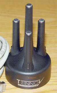

Simple practical question. To set up Dirac live on a my CAPS 2.0 server, I need a microphone / soundcard. I am planning on using my Trinnov microphone (as good as any I presume), which is battery powered and has ASE/EBU connectors. How can I connect an AES/EBU microphone to my CAPS 2.0 server (presumably using USB)?
I think the Trinnov has four capsules. I do not recall from my loaner unit but I am not sure if and how you would use a Trinnov mic with a standard soundcard.
Most measurement mics have one XLR ended connector, which you need to plug into a soundcard with phantom power.
The Trinnov is really four mics. To use it with Dirac, you simply use one of the four mics with one of the XLR connectors. Should work no problem. I even got the calibration file for my Mic from Trinnov. Do you think this devide would work to use the mic with USB:

BTW, the I believe three of the Trinnov mics are velocity based (X, Y and Z) and one pressure. So you can't interchange them.

I need Mic 4 on the Trinnov - this should work OK. I have the Trinnov calibration file as well. The preamp/mic works with other applications. I spend 1 hour on the phone with a Dirac expert, and we cannot get the preamp to work with Dirac. He thinks it is a compatibility issue. I will probably need to get another preamp. I had forgotten what computer audio hell was like..... 3 hours troubleshooting wasted....
