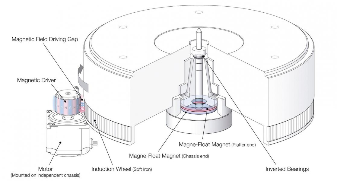

Your lack of understanding of motor commutation is obvious. I’m not sure if it is even worth my time explaining it to you as you don’t appear to have a clue of the basic concept. I will instead toss you a smaller bite that hopefully you can swallow. Take a look at the magnetic driver below:
What do you see? An alternating magnetic polarity arrangement. Have you ever seen a pulse train? Do you know another name for synchronous periodic drive? How do you think as Mike put it that the alternating or pulsing drive translate on the microscopic pico second time scale on the movement of the record relative to the cartridge’s stylus? Do you know what is driving the movement? An external digital clock is clocking the motor’s commutations.
What do you see? An alternating magnetic polarity arrangement. Have you ever seen a pulse train? Do you know another name for synchronous periodic drive? How do you think as Mike put it that the alternating or pulsing drive translate on the microscopic pico second time scale on the movement of the record relative to the cartridge’s stylus? Do you know what is driving the movement? A digital clock is clocking the motor’s commutations.

As I said above, you just don’t get it. Maybe someone will come along an explain it to you. You just don’t want to listen. Perhaps you can learn from someone else. Sorry but I just can’t get through to you and I made it as simple and straightforward as I know how to.
