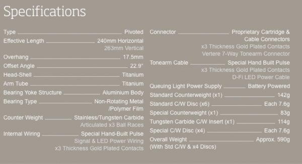

PeterA
Dec 6, 2011
12,669
10,942
3,515
USA
Bob, that is an interesting article. Lots of comparisons between the Vertere arm and the SME V-12. Does anyone know the effective mass of the Vertere arm? It must vary with the sliding counterweight. The SME V-12 is 12grams and the SME V os 10 or 11 grams. The argument in the article is that the longer the arm, the more mass has to be pushed by the stylus/cantilever/suspension and thus more compressions and stress on those parts. But if the effective mass of the longer SME arm is actually less than the shorter Vertere arm, it seems that that argument is not correct.
What is really going on here with effective mass, and the work that a cartridge must do, and is this area of concern more important than resonances and tracking error?

Some of you here are among the analog elite of the audiophile higher end.
I'm ready to be educated.
I posted that article from Mono And Stereo because not only was it relevant with the tonearms's length but also because it was seriously written and included some of the top analog audio guns in the industry.
Is it the ultimate definition? No, as David remarked, and as Peter is questioning as a scientist explorer on a quest to turntabling expression.
And it's not about Michael Fremer the man, but about what the man says. Is he the absolute authority with the last words? No, he's an audio reviewer in constant experimental ground, a searcher, like John Wayne.

PeterA
Dec 6, 2011
12,669
10,942
3,515
USA
_____
Vertere Reference Tonearm
I saw that and no mention of effective mass of the tonearm.
