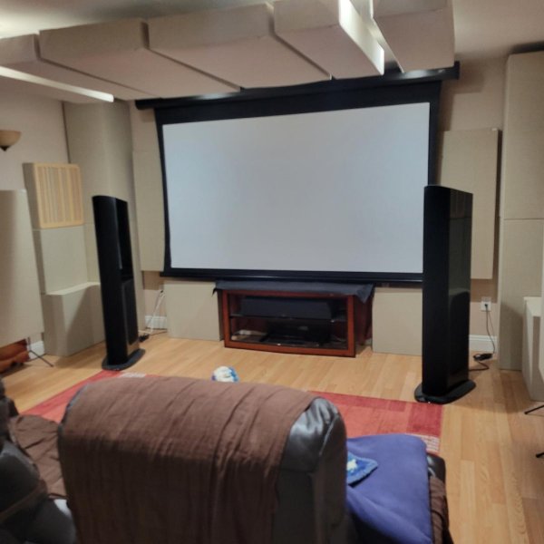

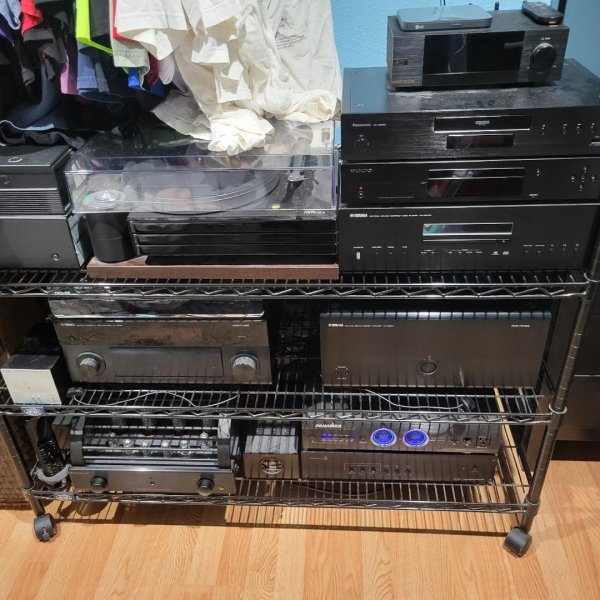

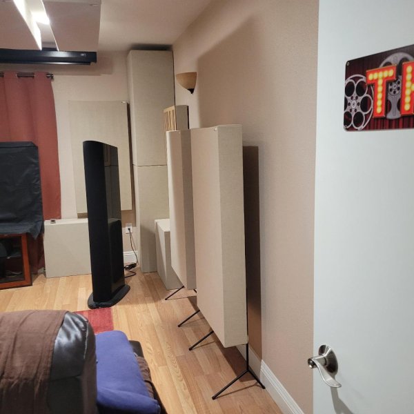

I am a big believer in treating the room, so here are some pictures of my Home theater, music listening room. Enjoy the music.
