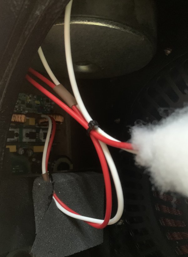

Yes exactly. You just carefully remove the grey foam, and then after installing the crossovers you find new location for it. See these two pics of my installation: Some of the foam is now further down in the cabinet, and some is on a vertical bracing. It does not really matter, where you locate it.
The close-up picture with red/white wiring is the stripped Furutech wiring for the subwoofers.
