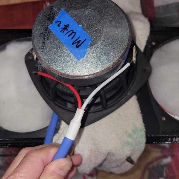

Morten, just to be clear, the overall length of the MTM wires seem adequate, however, the wire ends as presently terminated seem a bit short for the midwoofers at @ 3 inches each.
Yes I see there should be a longer length where the insulation is stripped. I’ll let Tony know together with your other feedback on the cabling.
From your picture it does seem like the cable could be a bit shorter, but you figure this out with your speaker guy on saturday :)

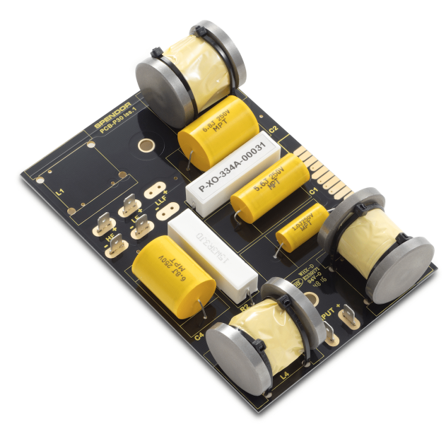

My speakers are fairly well designed, as far as my experience goes. I’m pretty happy with them at least. I just would like to upgrade the existing values for better. As far as I can see it is a pretty simple design and could use a upgrade.

Let me offer my perspectives also Wolff.
The crossover you show in the picture has slightly higher quality parts, than what we have as stock in the T Ref’s: Higher quality coils (better core material) and what appears to be more solid connectors. But still a crossover with a part quality as expected for speakers at this price point = You can expect similar improvements as Mark D and I have described for the T Ref.
I have known Tony Gee for 20 years or so. He is exeptionally skilled, and also very honest, so from my experience you can trust his advise on what to do with your speakers. He is also doing a lot with both similations and actual measurements between the original filter, and the new filter to make sure they perform identical = you keep the signature of the speaker, but get improvements as mentioned by Mark D. Also, he will suggest a solution/price level, that makes sense for the speakers.
In different situations, where the speakers have obviuos problems (bad design) Tony can then design a different crossover, but that’s a different scenario, as you mention this is not what you need.
