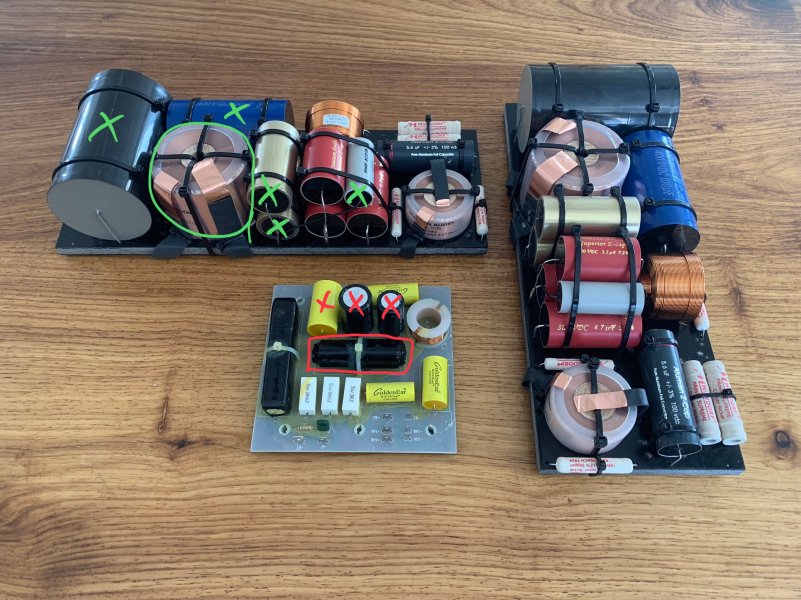

Just to touch a bit on the price to performance again: As mentioned in the beginning of the thread: To me, this is the highest quality/price parts, that makes sense in these speakers. These are parts you will only in very expensive commercial speakers, but I could have choosen MUCH more expensive parts. The parts are not cheap at all, but worth it too me. If you find this is too much money, there are also cheaper options, that will still be a lot better, than the original parts. I’m sure Tony can help…
Even if this is quite a simple (and well designed) cross over with relatively few parts, there are parts driving the cost up by quite a bit, and I have tried to illustrate two examples on this picture.
There is a large 460uF cap in series with the mid-woofers. On the original cross over this cap is made by two large electrolytic caps and a 10uF polypropylene cap in parallel. See parts with red ‘’X’’ on the original board. On my cross over it takes all the caps marked with green ‘’X’’ to create the 460uF cap with high quality polypropylene caps, there is even a very high quality copper foil bypass on there. All those caps cost serious money, and take up quite a lot of space.
Another example is the woofer coil, again on the cross over for the midwoofers. On the original board, it’s the one I have circled in red in the center of the board. It’s a nasty iron core coil… On my cross over that is replaced by the big foil coil circled in green. Again, such a nice big foil coil cost real money…
And the list goes on…
Again: The T Ref’s are very, very well engineered speakers, but build to a low price point by high end audio standards, so compromises must be made to keep cost low.

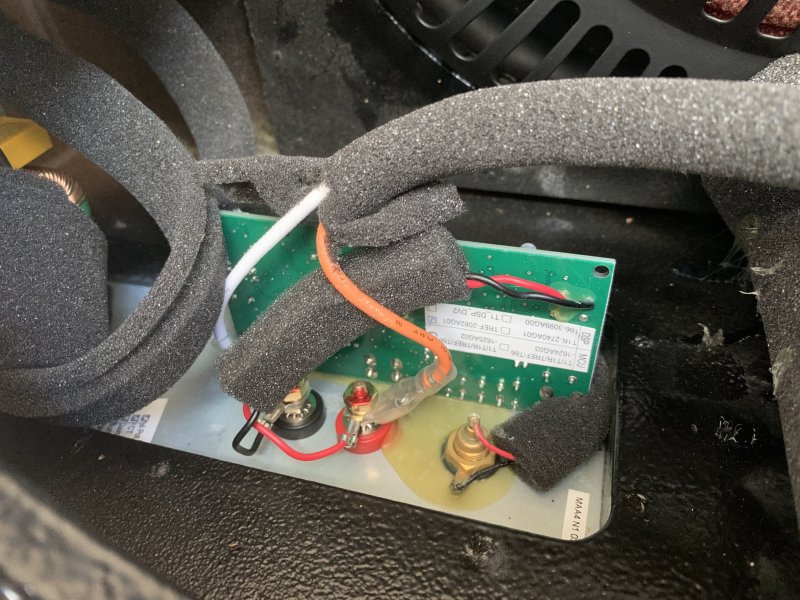

BTW, the wires does not go to the amp, but to the DSP board located just next to the binding posts, it’s the small red and black wires glued onto the PCB in this picture.
Why not? The wires are soldered into tiny holes on tiny PCB traces on the DSP board, no way to get fat speaker wires soldered on there, and if one attempted to do that, the heat from trying to solder fat cables on tiny little traces on a circuit board would ruin the board. That would be stupid. Also I bet that noone would be able to hear any difference what so ever on a few centimeters of wire going to a DSP board on a subwoofer section. I cut of the connectors on the small black and red wires, and soldered these wires + the Furutech wires into the new binding posts.
No, I did not change the wires from the DSP board to the amp either. You can do that of course, but you need to source the proper connectors, crimping tools etc, and you will not hear any difference. Basically I left the subwoofer section as is, exept for replacing the wires from the amp to the woofers with the Furutech.
