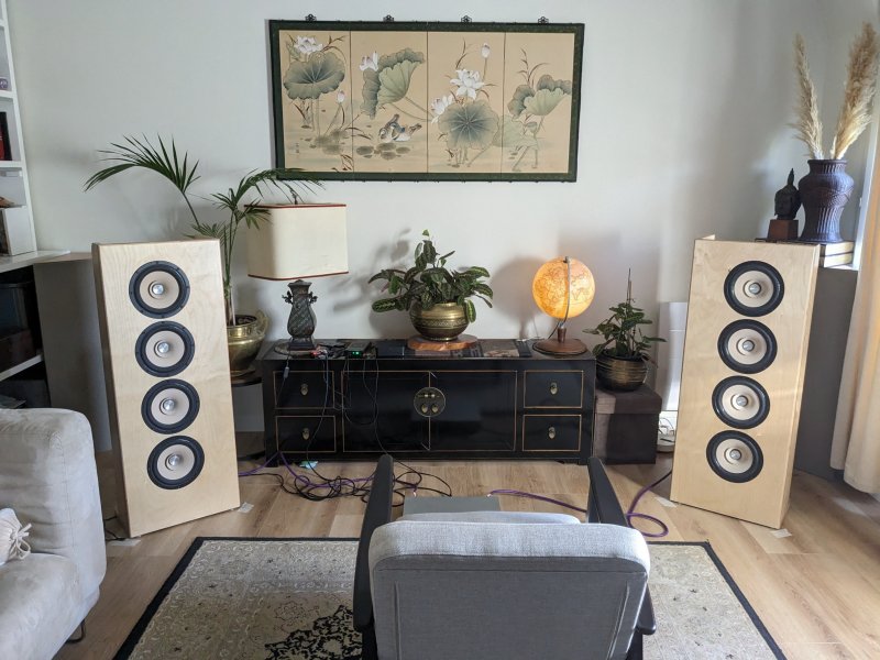

Now that I am done re-wiring my two speakers, I worked on the speaker placement in a more "near-field" configuration with the speakers placed facing the length of the room. I still have the option of placing them along the width, but this is easier to setup and good for late night listening.
I used a combination of measurements (frequency response, RT60...) and listening, and found a placement I actually enjoy, meaning it provides a relaxing, "enveloping" sound, with well defined instruments.
My head is about 2 meters (6.5 feet) from each speaker, and the speakers are about 2.2 meters apart.
Here's the system in action:
The sound also fills up the flat nicely.

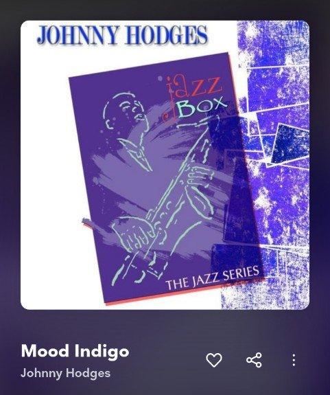

What would you say the differences are comparing your vinyl playback to this version of Johnny Hodges?
