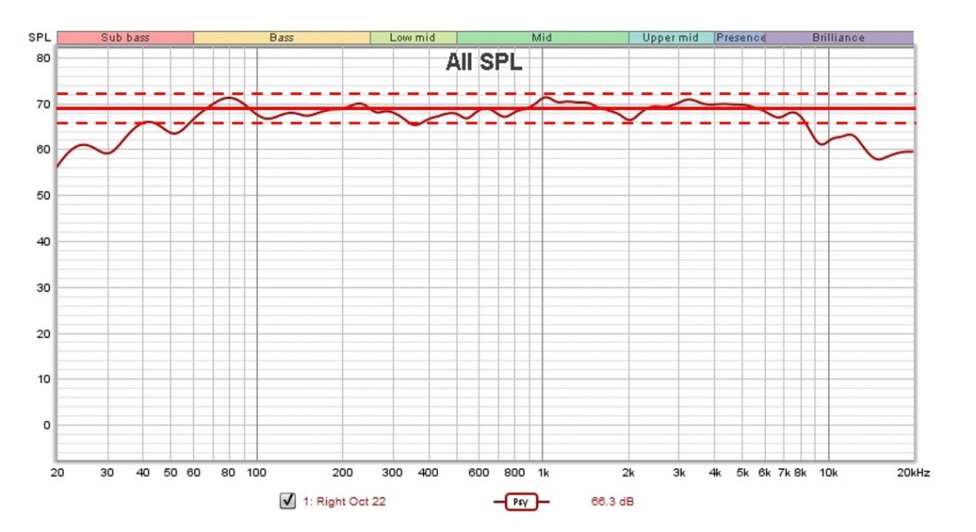

Results of a different speaker placement in my room - this frequency response curve (psychoacoustic smoothing) shows variations of (generally less than) +/- 3db between 60hz and 8kHz, and it sounds good (better) to my ears. Bass response and high frequency response will be improved...
Bass could use a boost but HF not as it will sound too bright in room.
Reactions: hopkins
This was actually taken with added tweeters, but I need to fine tune their placement on the baffle (and tilt). Without the tweeters, the HF response is more variable. Concerning the bass, I would be curious to try subwoofers at some point, but I may also play around with baffle wings. The overall response is very similar on both speakers, as they are now placed facing the length of the room, in a more symmetrical setup. With my speakers facing the width, the response of the left speaker (towards the side wall) was very different from my right speakers, and the bass response on that speaker was not good - but the added distance between the two gave a very nice soundstage which I appreciated. With the speakers closer together, my seating position is much closer, and I can play music more softly. Still working on all this...
Your amp is likely somewhat over damped for full range drivers in an open baffle configuration…it might necessitate subs…then think dipole subs…or you will have blending difficulty.
I don't think the amp is the issue. The manufacturer used these baffles with a number of other amps (solid state, tube..). Bass response is limited with the Tang Band, my baffles are probably a little too narrow, and the room does not help. But yes, dipole subs could ultimately blend well. I am in no hurry, however.
