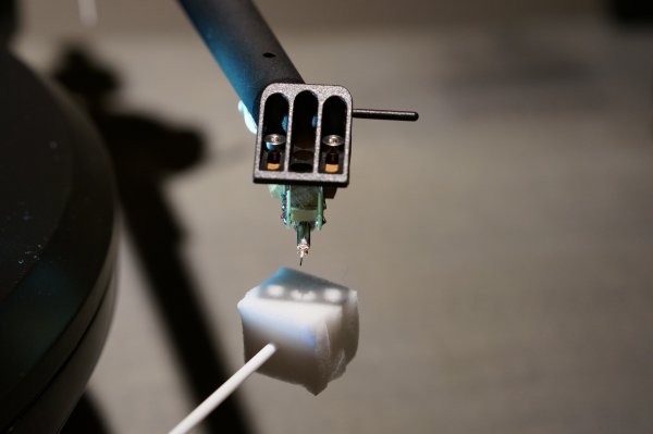

Can you post a picture of the ME setup you use?
I raise the ME to just touch the stylus. Usually I see the stylus tip dissapear a teeny bit into the foam. Different from Peter, I do not rub or pull on the ME in any direction - just dip. My 'fear' is the stylus will catch or be grabbed in the ME - different folks have different technique; just saying what works for me. You can see a high magnification picture of the ME foam in my earlier message.
Wrt to other msgs. I would not / do not wet the ME.
