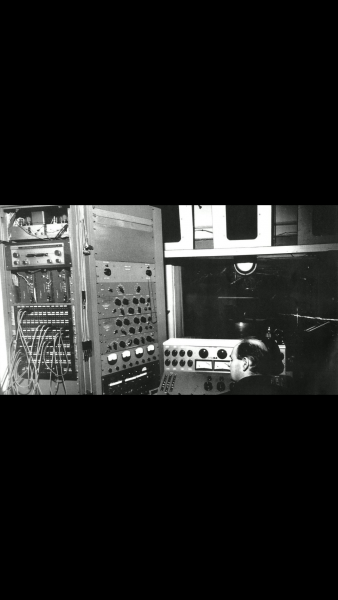

There really isn’t anything new here.....
David Sarser at RCA studio 3
