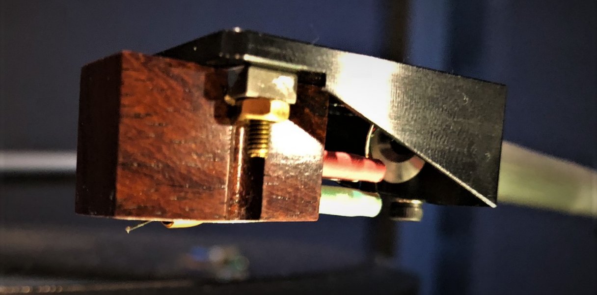

I've shirked away from using this RSP in the past; it had sounded slightly lightweight in bass (relative to stones). But in the past few years system upgrades have happened, gear changes, and I quit drinking which does at least slightly affect my hearing preferences. These sober ears need a softer top end now - I'll be trying some copper cables to replace my silver, lol. And man, that EAR really brings out the low end. It's really a lovely change of pace for the time being with RSP / EAR - very well balanced, smoother & creamier than the Blue Lace Diamond / Koetsu SUT which is more detailed. Time always sorts these things out for me, so we'll see where it goes.

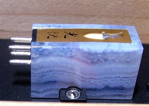

Incidentally I find the Blue Lace very frustrating to photograph. The delicate fine lacing gets so easily washed out with light. Here's another attempt where I had the main face in soft shadow and had to goose the contrast & saturation to bring the grain back.
I think so. There is something special with the Rosewood body sound.So I own Rhodonite, Blue Tigereye diamond and Coralstone mono ... do I owe it to myself to try wood bodied RSP?

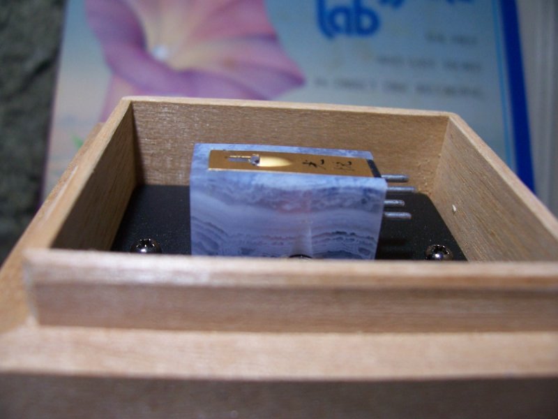

That Blue Lace is wonderful! Looks like it probably has a more striking /contrasted grain than mine.You're right about lighting and getting its grain come out nicely. I kept these pics from 2006, before the client took it. Got lucky with the table lamp lighting.

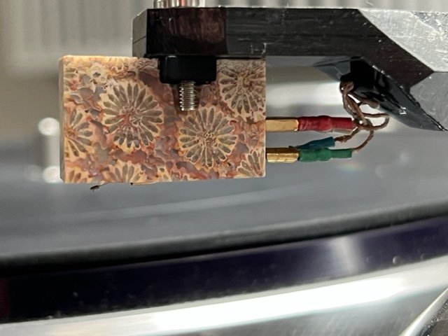

Wow that coralstone is beautiful.After more than one year i dont listen my coralstone diamond,and after reading again this thread,yesterday i put my Koetsu on Vyger,with phono CH P1 at around 80/100 ohm and i can tell is really a fantastic cartridges,big scene and deep,very natural on voice and perfect for lazz,choir and chamber music
