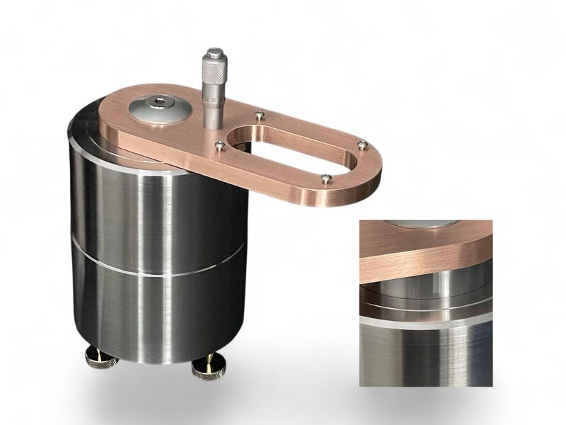

Nope I brought over one of the Kuzma's base plates with the 3 holes that would bolt onto the table and they are a bit larger so that will not work.

By looking at the photos in the review, looks like the arrangement is similar to that of the JC Verdier, with the armboard attached to the pillar using a bolt. If so, an easy way maybe to machine a new armboard to fit the Safir.
Yes, this should work alike. You must design a two-piece-base as shown for my 4Point 14"

Thanks phoni but who would be able to manufacture such a piece? Palmer is no longer in existence.
