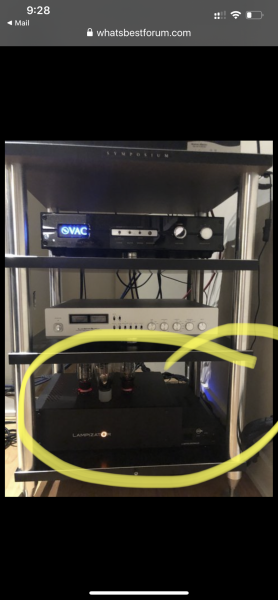

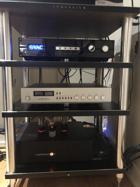

So my gear sits on two stands separated by a couple of feet. On the left side I have my LM805ia amp and Lumin U1.
Off to the right I have a rack with the Lampi and VAC preamp. The Luxman EQ-500 also is input to the VAC. My TT sits above. The only thing out of the ordinary is that my USB cable is unusually long at 2m to cover the distance from Lumin to Lampi.

take the dac and place it on the floor in front of the rack. Doing so greatly Lowers Emi and rfi as Well. Just as test ok. If it solves it place the dac aside of the streamer.

Anyting tubes is bad to stack yet we all do it including me lol
Yeah, I'd place the Lampi next to the Lumin but then I have a long run back to the preamp. I could slide some gear around on my BDI credenza but I'd still need a 1.5m SE cable to connect to the preamp.
