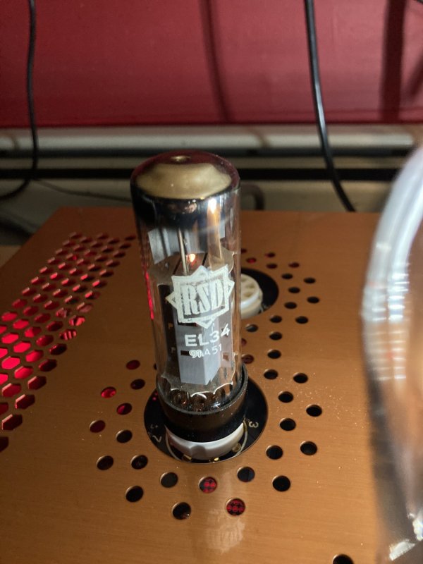

Would you mind posting pics and I'll help identify them? They made many different variations from 1950 - 1980's.

Are those with the dimple top?

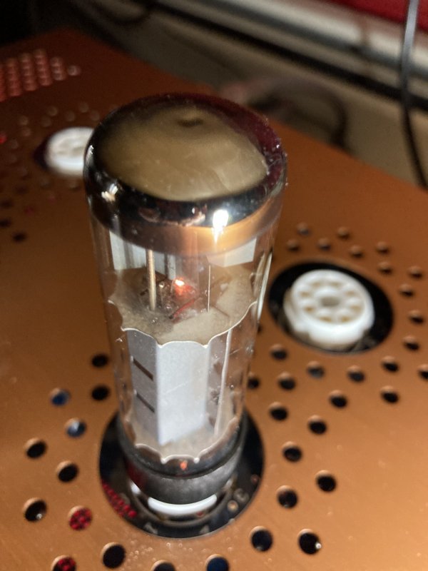

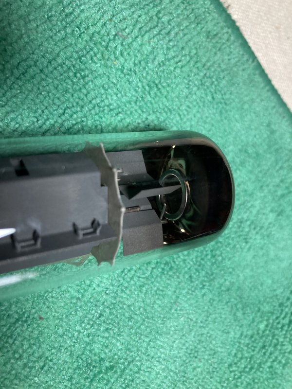

Sorry I should have specified - one more pic showing the getters at the top :)
This tube says "RSD". RSD were a West German rebrander of tubes from various manufacturers including RFT from East Germany. Also Russian tubes, and later Chinese tubes. These do look like RFT, although the '91' date code (1991) is throwing me.
Are there 3 or 4 holes on the sides of the plates?
Are there 3 or 4 holes on the sides of the plates? 4
Is this better?

Holes are sometimes a way to identify models or model years, but be aware that correlating the number of holes with sound quality, as often comes up with 6SN7 and its variants, is often false according to those who've actually compared. In the case of the 6SN7's, for example, the three-hole reputation for Sylvania "bad boys" was apparently the result of an eBay seller's posts on a forum or two, in order to drive up prices. Same apparently goes for some claims about round plates being better than flat plates (Tung-Sol)

We’re just identifying what the tubes are and hopefully a rough idea of where and when they were made.

I do believe you have one of the last ever RFT tubes produced. Most guides say they were produced until the late 1980's, but it looks like that one is from 1991. It has exactly the same construction as the 1980's tubes, but with a slightly later 1991 date code.
Here you can see RSD El34 tubes with 92 date codes.
But remember RSD were a rebrander and didn't actually manufacture tubes. RSD tubes with 1990's date codes are usually Chinese or Russian tubes.
Perhaps RSD had a batch of RFT tubes from the late 80's and added the date codes and RSD branding on the tubes just before selling. Probably too much info for most folks on here who are probably only interesting in how the tubes sound! My apologies for being a history and tube nerd :)
No, I enjoy the history lesson.
