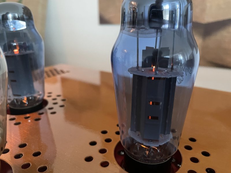

New tube alert:
sophia electric EL34 blue tubes.
I think I’ve found a tube that has the mid range characteristics of the GEC KT66 and the bass and output of the Tesla EL51s. Someone was selling them on usaudiomart and I bought the pair for $125. Didn’t expect much from it but I was pleasantly surprised.
the mid range voices keep getting better and better. The piano transients are better and the bass is certainly better than the KT66. The tubes also look sexy
here are some pics.
731BF2AD-662E-4D0F-B1E6-80D0BF389578.jpeg B9E8719F-A2BB-4688-8D99-F01333E206AD.jpegCD4D629D-7658-488F-B4A4-06D16B9AF477.jpeg780E5C01-52A3-43A9-A78E-B7B010D834B6.jpeg9C415B05-7484-46CB-9ABD-786A924C12D3.jpeg
Which rectifier is that?

Yes the GEC KT66s are awesome tubes. I bought them for 700 a pair on eBay. However I think you can get the Sophia EL34s online brand new for 250 a pair and in my humble opinion, they are on par with the NOS KT66s. If you like female vocals and mid range, you'll love the GEC KT66s.
My clear tubes are great, I have heard that the dark tubes are better, but I think the clear ones are equal to the black ones. I guess @shadowlight has a pair (dark tubes) that he may be looking to sell.
Got it. I should have seen that. Love the blue. I see the el34-st on line. Is that the same thing?

@Shredder i wasn’t that impressed with the psvane tubes (both rectifier 274b and output tubes)
my fav combination is (was)
1. usaf 596 rectifier with GEC KT66
2. Usaf 596 with Tesla el51
now the new fav is
1. shugang 274b with Sophia el34
I am yet to try the Sophia’s with the usaf 596.
the good news is the shugang 274b can be bought for 30 bucks.

Very helpful, thanks. I just ordered a quad on the Sophia's. Very excited.
