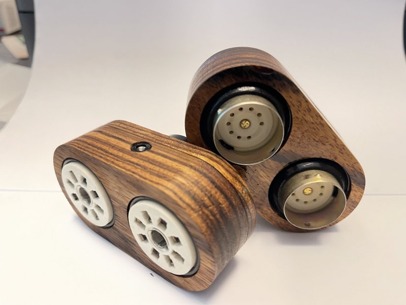

Soft launch of the C3g and E83f adapters from hardwood. These are the prototypes, listeng test tonight:)

We had the world premier of the TP adapters tonight in my listening room. TP is for my and Tibor’s family name Takacs&Pinter:)
Not sure I'm the most credible to promote my own product. I try to remain objective and speak as a user. So I'll just say that these adapters are f…ing great.:)

As i told you via WhatsApp those look amazing. Good job done.
What is that mesh wire doing around e83f?
These are epic adapters. I will get some soon!

Can anyone give a layman’s explanation of why a single small signal tube needs to be replaced by a pair of these C3G?
I dont know the technical details, but I do know the local Horizon tube-rolling experts are on to something. I had the honor of meeting Lukasz at a show here and mentioned this tube configuration. He said he wasn’t surprised it sounds good and mentioned that he is experimenting with a dac configuration that has 4 driver slots like this built in inherently…
no one said it needs to be replaced by c3g but the sound is simply amazing. FWIW all signal tubes are not small. Previous to the c3g I was using Mullard brown base ECC32
The small tubes originally fitted are dual triodes i.e. two amplifying devices in a single tube. Each side handles a single phase signal eg rca output only uses one triode section but xlr uses both. The c3g and e83f tubes are both being run as single triodes, so two are needed on each channel to pass an xlr signal. Hence the dual adapters. Same story for 6j5 which is a half / single triode version of 6sn7.
