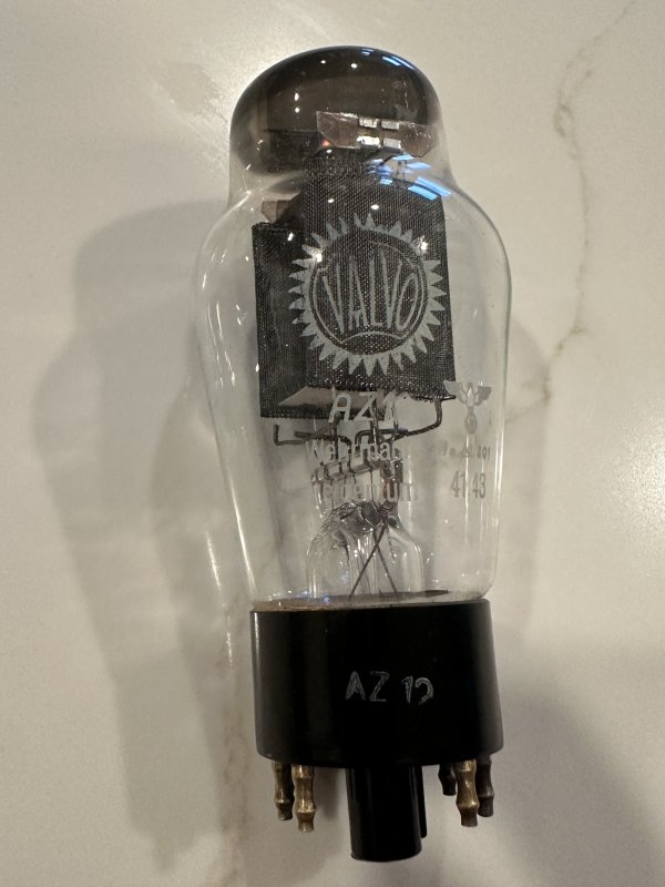

Here are better photos. Box said 1943
Reactions: John T

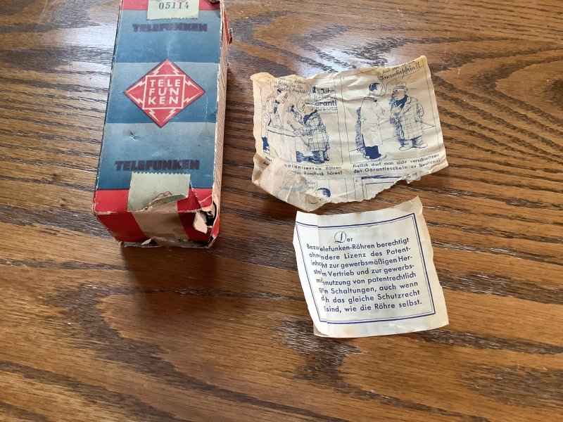

This is pretty cool. In the box the text is patent information. And also in the box was this cartoon. My German is a little rusty but if someone who does read German can translate I would appreciate it. Its a little hard to make out...
Reactions: christoph and Blake
Interesting; On My Telefunken AZ12 Mesh, The Plate appears much longer than on the Valvo...EDIT After looking more closely they appear very similar...
from what Understand, as I have not done the comparison, there is a sonic difference between the TFKN AZ12 silver mesh and the Valvo AZ12 black mesh, but as I said before these tubes are so close it likely matters not

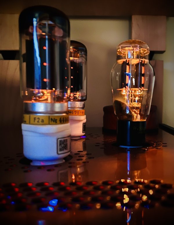

Few pics just for perspective of the YEARS of audio heaven we have gained from tube rolling across multiple Lampi DACs!!
Laszlo's adapters are NOT the issue...
Reactions: Sampajanna
I think there's a large number of WBF members, myself included, who have safely rolled numerous tubes across multiple Lampizator DACs and would not hesitate to do so again. Testimony to this would be the almost 200 page threads on various Lampi tube rolling. And many of us have had perfect experiences with numerous TP adapters + tubes thanks to @takacs75 and would vouch for this.
Obviously there's a risk to tube rolling, but I think that's par for course even if you buy a replacement 5U4G. I wouldn't want to own a tube gear if I cannot tube roll, there's little point to that.
