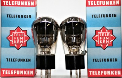

I think it is about 4V, 0.6A. I am with Goran, don't bother trying it. It won't run optimally in a Big 7.
The Telefunken was 3.8V, 0.6A.
There's some real Telefunken's on eBay right now.
I would definitely buy these over any KR copy.
Who wants copies? Go for the real deal.
Reactions: RDSChicago
Would the Telefunken 242 work better on Big 7, or stay away from that tube?
You don’t have correct setting for those tubes so do not waste your money for something which won’t work (my two cents on this topic)
