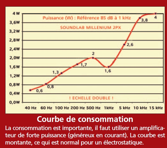

AFAIK, the figure usually specified in not the efficiency of the speaker, but the sensitivity is just the measured acoustic level at 1m using pink noise at 2.83V RMS - as 2.83V over 8 ohms is 1 W, it is often abbreviated as dB/W. It is aimed to allow us to control what volume we get with a certain voltage - but as manufacturers specify the power of their amplifiers at 8 ohms we often use it for a first (sometimes misleading) indication of compatibility.
I share your feeling above sealed speakers versus ported, but I acknowledge it must be wrong... Perhaps it is due that usually ported speakers are larger than sealed ones and have higher sensitivity, and we associate them with lower power amplfiers. ;)
BTW, the french magazine Nouvelle Revue du Son has been showing the measurements of speaker efficiency in a much better way for long:
This does help...so the chart shows that to produce 85dbs...you need the amount of wattage on the left of the chart to get a particular frequency (at the bottom of the chart) to hit 85dbs...yes?

I agree with you , my mistake, efficiency would have been a figure of Acoustic watts over electric watts. In the audiophile parlance we do talk however of High efficiency speakers not of high sensitivity although the former is correct.. I did follow the audiophile usage so I am sure you did get my point...
So to be on the correct side let's use the proper term: sensitivity. Taken from the Magico web site, they state the sensitivity of their Q5 at 86 dB/w/m taken at 1 watt at 1 KHz, ... If we use the nominal impedance of the speaker, 4 Ohms 2.83 volts at the output would produce 2 watts not one (1) watt of electrical power, thus to compare this with a speaker with a nominal impedance of 8 ohms you would need to subtract 3 dB from the stated sensitivity and this at 1 Khz. Averaging it from the standard 300 to 3 khz (forgot where that came from but that is the requirement ) ... This speaker, the Q5 is likely at best an 83 dB speaker ( 3dB less compared with a 8ohms speaker that would have had the same ratings) maybe less and this is a game many manufacturers play ... If the sensitivity of the Q7 is measured with the same protocol, it should be compared to a 91 dB (at 8 ohm) speaker and since the output is not averaged between 300 and 3 Khz , it is likely less .. I would guess in the 89 dB range ... It is not a high efficiency/sensitivity design as the stated 94 dB would suggest ..No proof, simply call it a hunch.. Jeff Fritz has the Q7 and could chime in .. As for the cabinet vibrating, it could be a case of a defect with that particular sample.
