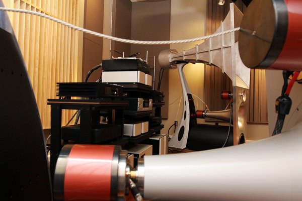

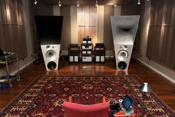

You have stated that your are going the 5 way active route with 4 amps & sub amp and 5 DACs with only one D to A converting right at the amplifiers. The question is besides using 2 DEQX units or a Behold system with each amplifier having the DAC for a 5 way setup with digital input, what other system can do this in the digital domain before converting? . I am aware of the 5 way Marchand but that has to convert A to D then D to A again.
To Stereo
Digital XO, EQ (if needed), time alignment between drivers and crosstalk cancellation (if wanted) are done directly in Audeeva Conbrio server... (using Fourier transformations). Everything that enters the (Conbrio) XO exits it at the same time, separated into the various freq components. We control that with sub-sample delay shiftings.
No analog XO could ever do that... and most conventional XO introduce horrible phase shifts. Additionally, all active analog XO have input and output buffers, which are also not fully transparent. We eliminate that problem.
The server directly outputs 5 digital signals to 5 DACs synched by the same word clock. Each DAC is connected to a different analog integrated amp (the sub amp + 4 amps to be chosen).
What about feeding drivers with souch high sensitivity from some strong preamp directly? >for low level SPL ofc.
The server and XO are in one case together or separate?
