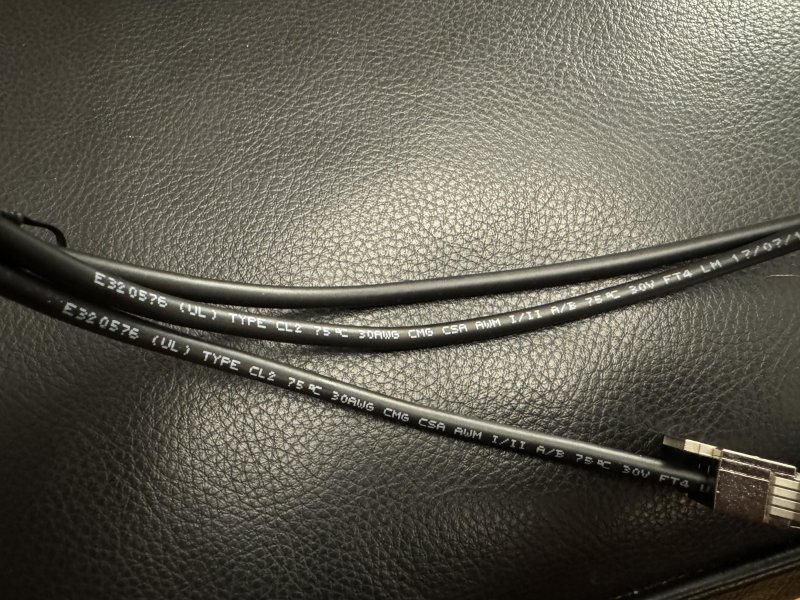

Good idea :) Amphenol SFP+ 10GbE direct attach passive copper cable (DAC), quad-shielded 30 AWG twin-axial SKEWCLEAR wire
(SF-SFPP2EPASS-002)

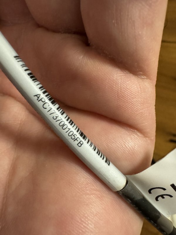

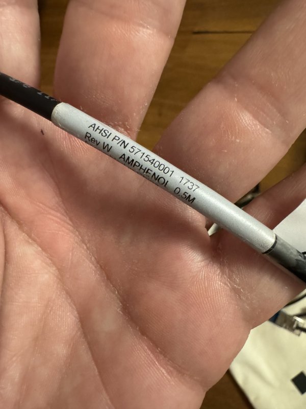

The Afterdark version did arrive here.
Unfortunately I cannot evaluate them, as system is down for other reasons:(
