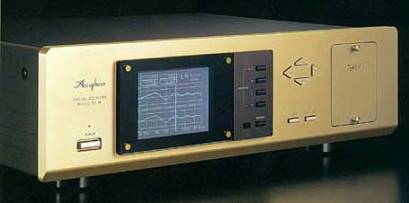

Accuphase DG-68 Digital Voicing Equalizer

It seems that JVS had been fascinated with Accuphase DG-68 Digital Voicing Equalizer .
I had been usin DG-28 model since 2001.
This weekend I will bring DG-28 down to second floor ( I have only few items left on third floor including my headphone set up and etc).
Altec A7 gave enough signal at 31.5 hz, but only faint rumbling at 25hz, 20hz, when I tested Stereophile test disc.
I may try to have A7 to give deeper bass and more flat response through all frequency.
