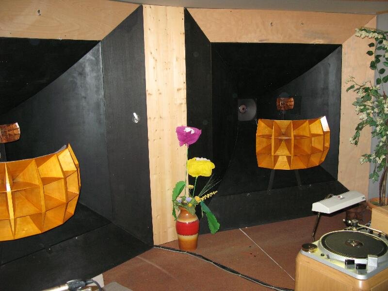

2405 vs 2404 is a preference. Former is more forward directing and latter is more lateral ambience. Also, if you have wooden multi cell sex horn from Markus klug, for his own JBL tweeter he built a small multi cell instead of butt cheek. It just keeps dispersion of both the midrange and tweeter driver the same
Multicell for jbl 075 like dietmars horn speakers
