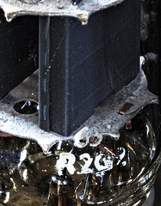

sorry I forgot I still need this code from your tube to safely identify it

if the code is correct, because handwritten then that means the following the top row only gives the type of tube.
R2G2
If its a 4 character code, the valve was produced post 1960
The first character gives the production site
B : - Mullard, Blackburn
D: - Valvo, Hamburg (Germany)
G : - Mullard, Fleetwood
J : - Mullard ( British Tungsram), Tottenham
R : - Mullard, Mitcham
X : - Philips, Sittard (Holland)
Y : - Philips, Sittard (Holland)
9: - Philips, Heerlen, (Holland)
The second character
0: - 1950, 1960, 1970
1: - 1951, 1961, 1971
2: - 1952, 1962, 1972
3: - 1953, 1963, 1973
4: - 1954, 1964, 1974
5: - 1955, 1965, 1975
6: - 1956, 1966, 1976
7: - 1957, 1967, 1977
8: - 1958, 1968, 1978
9: - 1959, 1969, 1979
The third character gives the month of manufacture.
A : - January
B : - February
C : - March
D : - April
E : - May
F : - June
G : - July
H : - August
I : - September
J : - October
K : - November
L : - December
The fourth character gives the week of manufacture
1: - week 1 of month
2: - week 2 of month
3: - week 3 of month
4: - week 4 of month
5: - week 5 of month
That means your tube was produced in Mitcham in the second week of July 1962;)
