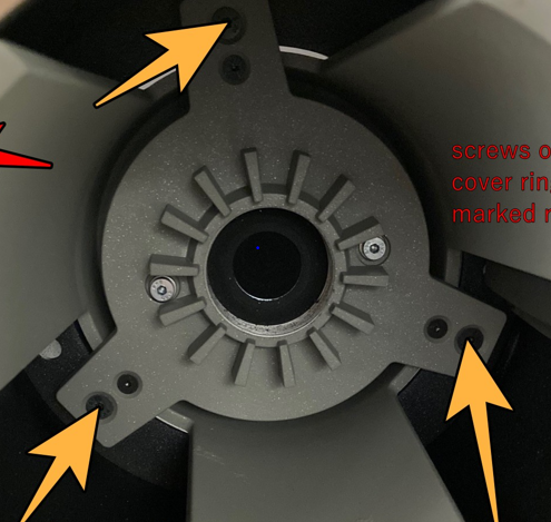

Avantgarde speakers do not use a compression driver. It is a textile dome at the end of a horn.
The type of driver does not affect the objectives achieved (and detriments) with an attached horn.
I agree with this statement. There are examples of good and bad implementation of all of the various speaker technologies. I was simply correcting the statement regarding compression drivers as it is misinformation.
The tweeter is a compression driver but the midrange driver is not.
Here is a picture of the tweeter. As all can see it is a fabric dome. The horn screws into the threads resulting in a dome tweeter firing directly into the throat of the horn.
They must have changed then in the latest generation…I know older Trios had a Beyma compression driver for the tweeter.
Just checked, the previous XD version still used a Mylar diaphragm compression driver. I think this was basically the Beyma Cp-380m, which is an excellent driver.
Now I am confused, The Audio Best review says the G3 tweeter is annular, not a dome. An annular tweeter is usually a compression driver, this is what JB, BMS and some others started making as they avoid breakup issues that most compression diaphragms suffer.
Let me get the specifics. I believe the new zero uses an annular tweeter. But need to check. BRB.
Until before G3 the AG Trio used a custom Community M200 for mid (2 inch compression driver for 600hz-4khz) with the Beyma CP380M as a tweeter (1 inch compression driver for 4khz+) and Duo an Uno models used cone driver for mid (modified Davis cone driver) with Beyma CD only for tweeter.
