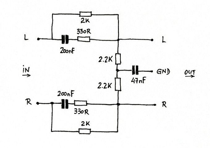

ok you mean a crossfeed circuit like a headphone amplifier is used. to create the feeling of sitting in front of loudspeakers. a controlled crosstalk is inserted there without degrading the sound quality. I can not imagine that lamm would worsen the channel separation.
Exsample crossfeed shematics

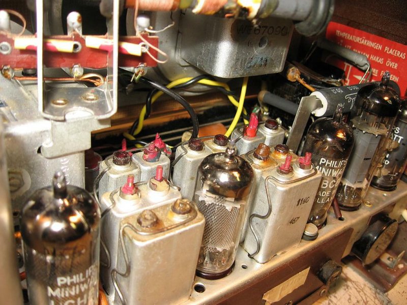

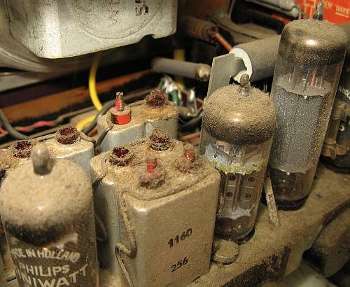

An Edison lightbulb has been on for over 108 years. on the subject of dust.
tube radio phillips not open for at least 50 years. cleaned very carefully too much water causes the old wood to swell. two tubes and one capacitors changed lasts again for next century.
P.S Radio ran before repair
View attachment 109531View attachment 109532

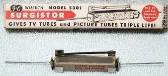

Current inrush can be controlled by a simple device called
wait for it....
A Current Inrush Limiter.
They cost a dollar or so. No box or special circuitry needed.
We've used them for decades- all of our OTLs (which have a lot of current inrush) use them. You can turn them on and off as much as you like no worries. CILs are a kind of thermistor with an inverse resistance characteristic- when cold their resistance is high, when hot their resistance is low. Not only does this take care of all issues regarding tube warmup (we do have a Standby Switch to prevent cathode stripping during warmup- it has its own CIL) and filter capacitor charging, it also helps switch contacts to survive. They are very reliable- we've never had one fail ever.

So you agree that current in-rush is a genuine issue?
Of course. But its easily solved by a competent designer by the simple use of current inrush limiter. No need for care about when the unit was last on, no worries about damaging something. It eliminates the problem.
They have not been around forever, which is why you don't see them in vintage equipment. But with any modern gear going back 35 years there really wasn't/isn't an excuse for not using them. They are cheap, reliable and they work.

This issue was solved over 50 years ago as well :)
Current in rush limiters are a simple solution if they are sized correctly.
While in rush current on start up can cause concern in a poor design, the on - off of consumer use is not generally the end of the world.
I use in rush limiters in some of my designs- they're cheap and effective.
