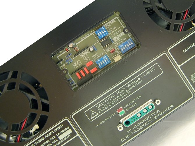

Did you ever try an OTL amp on the electrostatic panels? There was a company in the Netherlands that made a high voltage direct drive amp for electrostatic speakers similar to the old Acoustat Servocharge amps. All electrostatic speakers sound better without transformers.
Here
Reactions: christoph
Here
OK- that's cool!
4600Volts is a lot of Volts! Makes me curious how they expect it to be hooked up.
Is that a polarity switch (affects both channels) or does that only affect one channel? If the former, that is more common these days. If the latter, thanks for the update- good to know.

Right. So how to they connect to the speaker? I've not seen a connector like that on ESLs. Most of them I'm aware of would need to be modified.
you have to bring your ESL to them and they will convert it there. As far as I know.
There are no photos to be found on the internet pity.
