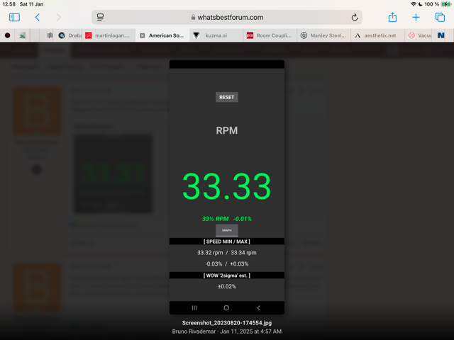

Ehhh ! Where are you getting this information from ? This is all the data supplied by the owner of this TD 124.
“ Stock TD-124. Fully restored by the best. Me
300ppm from 33.3333333 under dynamic load. Idlers ftw “
Absolutely nonsense, look at the data on the picture you linked to. :rolleyes:IMG_3537.png

I don't see where the nonsense about my comment and measurement is. Unless my math is wrong a 0.03% deviation is 300ppm.
It was your 33.3333333 number that had confused the poster, misunderstanding that your turntables speed stability was a match for the AS 2000, it is not. :) But surely impressive numbers for a idler.
It was your 33.3333333 number that had confused the poster, misunderstanding that your turntables speed stability was a match for the AS 2000, it is not. :) But surely impressive numbers for an idler.

So what does the 33.332-33.334 number in the AS TT mean? How is that measured? Is that an average speed during a certain amount of time or is that the actual minimum-maximum speed readout? (30ppm) I'm genuinely interesed in the roadrunner device but I don't understand how it works. According to what I just read it only shows a speed average with a very cool 3 decimal resolution. Maybe i'm missing something.
Take a look at that video. The roadrunner shows a number every 1,5 to 2 seconds. Acording to what we are seeing that turntable is as good as the AS turntable in terms of speed variation. It varies pretty much 1 decimal point once it's settled.
Reactions: Argonaut
That number every 1-2 seconds is the speed average measured over a period of time. Not the actual minimum-maximum speed.
There is much more fluctuation when running without speed variation feedback. Even when this turntable is with adjustment, Peters turntable is more stable. I have had that exact controller on a previous low torque motor, with adjustment it gets a little hazy in the treble it sounds better with more drift and no feedback. The AS 2000 is running without feedback, just the solid sine wave created by the controller, a special model created for the power requirements of this turntable.
