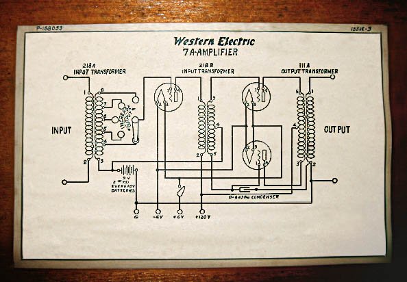

"THRAX SPARTACUS 300, pure 300B mono amplifier, partacus is a pure 300B mono amplifier employing x6 based on the legendary Western Electric 300B tube. It used six 300B tubes in 2 stages to deliver 50W of pure class A triode sound with not a single capacitor in sight."
. . . It used six 300B tubes in 2 stages to deliver 50W of pure class A triode sound
"The input is a 300B tube driving 4x300B tubes in the output stage "​
So one of the 300Bs in each channel is used as a driver of the four 300Bs in the output stage.
To get 50 watts from four 300Bs suggests push-pull.
Reactions: DasguteOhr
7Apix.jpgdriver stage 300b
Shunt regulator 300b voltage stabilisation
Output 4 x300b push pull
