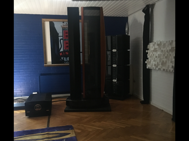

...oh man, if I "had" to cut out that beautiful herringbone oak, I would carefully cut it out, add the stone (or whatever you are laying) and glue the cut-out herringbone on top of the new substrate. A good floor guy can do that. Minimally invasive surgery.
But whatever you do, cool set-up. Good luck with the floor.
I would rather not cut my floor. I would try 6 layers tar paper on the floor with 3 inch thick concrete or stone slab on top. Speaker on that. Or a steel plate like Peter uses.
I say tar paper as I was working on a remodel on a multiplex. The owner found that around 6 layers tar paper under a floor board almost totally shunted the sound of a steel ball being dropoed on the board between floors. Call it mass decoupling. Anything other than cutting.
I thought about that too, maybe that is the nicest way to do it, thank you ! :)
Reactions: MarkusBarkus
I have a layer of felt under the big concrete tile now, vibrations are under control but it does not look great and i would not mind loosing that extra inch of hight.:rolleyes:IMG_3384.png
