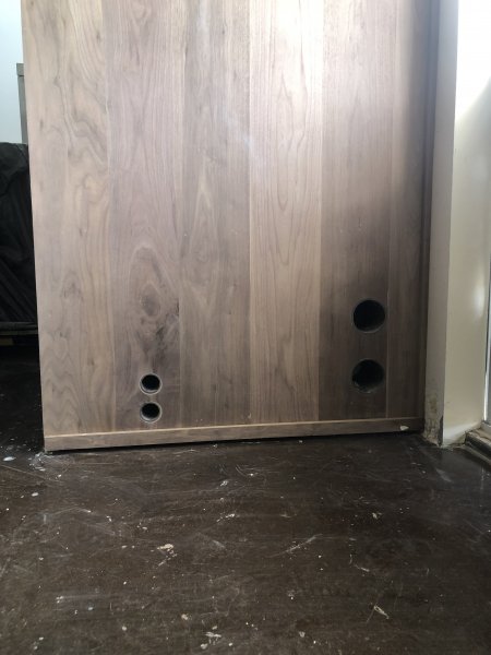

Thank you, David! I know you like the natural walnut, but I am still planning to stain it gray.
