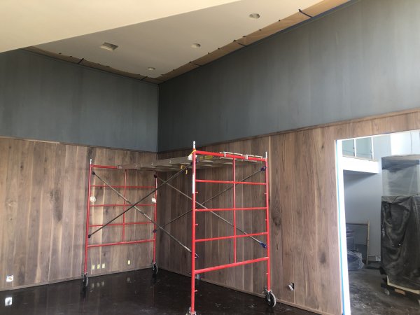

A bit of staining

A little bit of staining progress:
