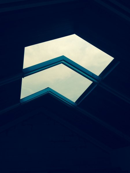

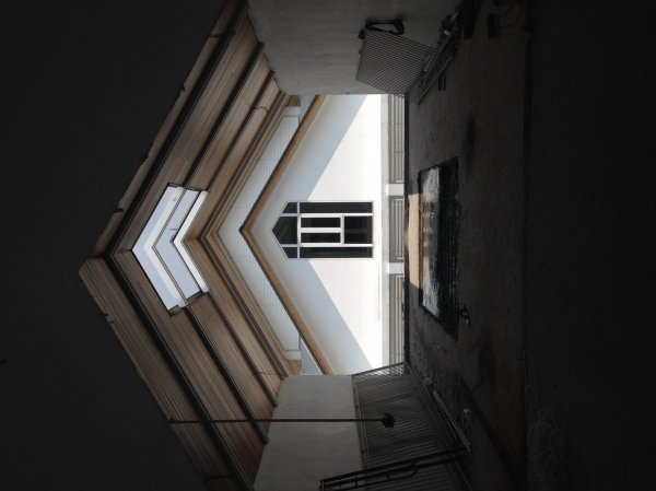

Renovated room will have a vaulted ceiling along the length of the room 28 ft long . Width 17' 10" . Side wall will be 7' 10" & it will peaked at about 12.5' .
I am considering sealing the smaller skylight area & it will be left with a reasonable size skylight (prob 4 x 5 ' ) which I m thinking of sealing it with a 15-20mm thick tempered glass . Was told that if it's thick , it will not be noisy when it rain heavily which is pretty often especially during monsoon season. Plan to hang panel traps 2' x 4' x 3" along the peak to absorb reflected sound due to the vaulted ceiling

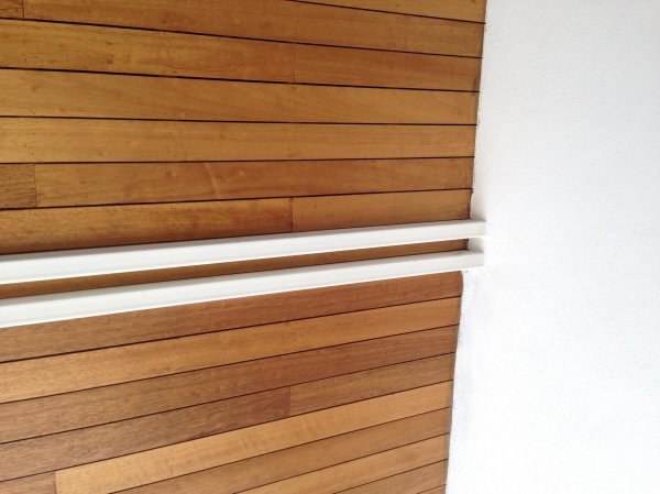

Intend to hang absorption / diffuser panel eg vicoustic wave wood on the wooden ceiling . I could easily build & hang some mdf / solid wood diffusers on the ceiling but wouldn't want to run the risk of it dropping on me or on my gears which I intend to place on the side walls . As you can see , I plan to seal the tiny gaps of the wooden ceiling with 2" wooden strut otherwise the whole ceiling is a helmholtz resonator !
My question is that instead of sealing off the current open air skylight to be consistent with the wooden ceiling , I m thinking of maintaining the skylight with thick tempered glass so that my audio room can be bath with natural lighting & when I m watching movie , I create a motorise mechanism to close the skylight . However would the tempered glass skylight affects my room acoustic ?

I would keep the skylights as I love the idea of natural light. However, as the sunlight in the tropics is very intense and because of the monsoon, I would have some kind of motorized shade that could also attenuate the sound of the raindrops on the skylight.
For the skylight itself, use laminated glass, and an air gap between two panes. This is not only for sound insulation, it is also for (some) heat insulation.

Glass in a skylight reflect about the same as drywall, maybe a little more above 4 KHz. As long as that part of the ceiling is not at a loudspeaker reflection point you'll be fine. The larger problem is the peak that extends the length of the room above the center line. Peaks like that focus sound, which is not what you want. So I suggest absorption (not diffusion) under the peak, along the lines of the photo below. Diffusion can be useful, but the more usual place is the rear wall.
