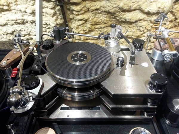

Every manufacturer that makes his own arm for his table will say theirs is the best. He is not the only one. MadFloyd you need to do this with your Kronos26168088_544313922593932_7423489570701929995_n.jpg

Every manufacturer that makes his own arm for his table will say theirs is the best. He is not the only one. MadFloyd you need to do this with your KronosView attachment 43105
I considered something like this on my SME 30/12. However, unlike the Kronos, each of the four suspension towers on the SME is slightly different because the load on each tower is different. Adding any weight from another armboard plus arm would wreak havoc with the balance of the finely tuned system. The Kronos seems different in this regard.
