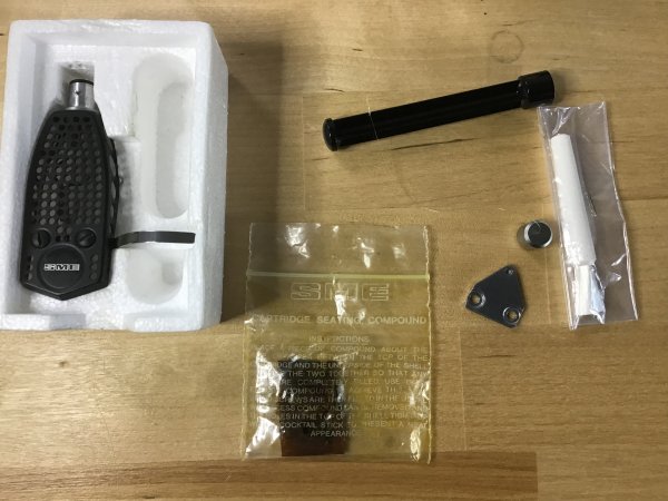

Just received my second 3013-R today. I plan to install it on my Raven for mono carts one day.
I am a bit surprised by some things.
The counterweight is not as big as the multi stranded barrel type.
There is a little plastic bag with « SME seating compound « written on it. It is for gluing the cart to the headshell. Never heard about that before ! Does anyone has experience with that ? It looks like... well sh..t (nos one if I dare).
Also a black piece of black plastic that I don’t know what it is made for. If someone can explain please ?
Serial number is 01882-R. Is it an old or more recent serie ?
Thanks for your help.
- The tonearm is missing the 2nd part of the counterweight to use with heavier cartridges.
- The sticky substance can be used to couple the cartridge and the headshell, this was common practice up to the 80’s, it was needed with the Series II not so much with the R tonearms.
- The black tool is a wrench for the base screws.

Ok thank you David,
Do you think I can buy an aftermarket counterweight complement ?
Another thing : the little counterweight on the way-rod seems to have a spring inside it is uninstalled but I don’t understand how to re install it.
I looked on the notice but there’s no explanation.
Do someone knows how to do that please ?

Ok thank you David,
JY
Sometimes aftermarket ones pop up on eBay but they don’t always fit or are made properly.
You might be missing another small part if the spring popped out.
david
