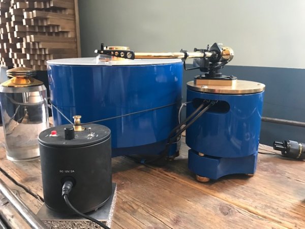

In the 80' many turntables followed a simple Design (like En Vogue Quasar) with external and separate Tonearm bases.
My "Blue Giant" turntable follows this direction.
The concept is mostly the same:
- heavy metal cylinder
length according demand
- top platter screwed with the individual Tonearm fixing
- base plate heavy metal (like the white Quasar) or separate coupled , like my Blue Giant, a customized Sylomer integrating base plate would be an interesting alternative :)
- for the use of SME tonearms a side opening for the cable is needed (can be seen on the bus base)
- SME 3009 or 3012 do favor bronce (or gunmetal) as base material. So a bronce spacer is added to the blue base
- Depending on the SME Tonearm the distance from base plate to cable connector is different, so the spacers do help as well to meet the side opening for cables measures.
- placing the SME cut out on the side and choosing the right radius for the cylinder makes it possible to use 9' , 10' and 12' SME tonearms (or graham or Groovemaster) by just turning the base around ( I had the 3012R fixed, now a 3009 gold)
