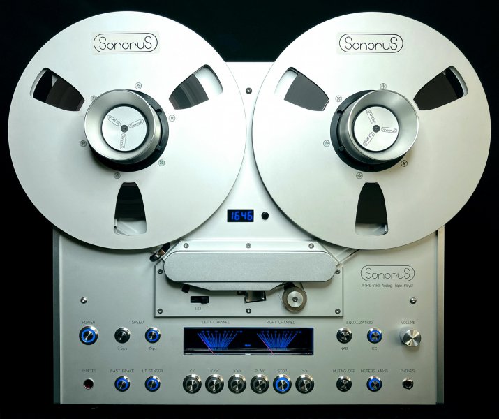

Sonorous ATR10 MMK II
It's only taken twelve years, but SonorouS have finally released the MK II version of their tube playback tape deck. Arian lent us an MK I deck, but with the MK II improved electronics for T.H.E. Show in Costa Mesa, I like the choice of winding speeds; Library Wind for proper tape storage is useful. I also liked the motor-assisted Fast Braking capability for easy searching. I also liked the digital counter, as the tapes I received did not have leader tape on them and I used the zero indicator, to show me where the beginning of the tape was. Price $32,500 - lead time, around 3 months. I will post some videos shortly. Cheers, Philip

That looks amazing. Bet it sounds amazing too!
I shot a few videos. As did Ron Resnick; I wonder what happened to his videos ?
