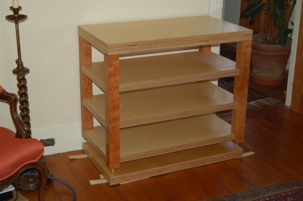

Very rigid and stable DIY 17 ply birch rack with cherry legs to match speaker aesthetics

I like the eq rack. Is it custom made? I am curious how the shelves and uprights were joined?
Thanks, audioarcher. Yes, I designed and built the rack myself. The goal was to build something very rigid as a support for the air-isolation platforms on which all of the equipment sits. It is designed specifically for these components and made to match the aesthetics of my Magico Mini2 speakers. The amp stands are similar. It is also as compact as I could make it so that it does not dominate the room.
The main rack is built up of 17-ply/inch birch plywood. Each shelf built up to 3.5" thick with a polyurethane finish, then hand sanded and rubbed with oil. The four legs are cherry, 2.5" square in section with notch cutouts to receive each shelf, which also has a cut out in each corner. The pieces are joined with marine epoxy. You can notice the front is recessed 1/2" and the sides are flush with the legs. There is a 3/16" reveal between each leg and the top shelf. The rack weighs about 150lbs. and is spiked to another leveled shelf on the floor to protect my soft pine floor boards. Two Lolli columns are directly under the rack in the basement to support the roughly 750lbs. There is no hand-detectable movement of the rack.
