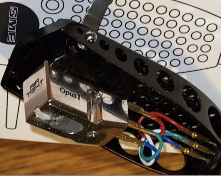

My good friend Madfloyd gave me a few days ago his AirTight Opus 1 to listen to in my system for a couple of weeks while he is on vacation. I have read a lot of good things about this cartridge. I own both an AirTight PC-1 Supreme and a MySonicLabs Signature Gold, so my expectations are high. I will first mount it in the SME V-12 and compare the combination of V-12/Opus 1 to my reference combination of 3012R/vdH Grand Cru. Here are some photos. Listening impressions will follow after I have spent some time comparing and contrasting the sound of each combination. I also plan to switch the cartridges in the arms to hear the differences and see if impressions hold.
The Opus 1 stylus tip to mounting hole distance seems to be the same as it is on my Supreme, so I used the MINT Tractor protractor for overhang and zenith adjustments. VTF is 2.1g and VTA is set by ear. I also confirmed alignment (horizontal tracking angle) with the DB protractor I use for the 3012R. Ian tells me the cartridge is fully broken in.
I will say that I am impressed with the build quality and love the fact that it has a stylus guard for ease and safety while handling. The cantilever straight and easy to align for zenith using the MINT as seen in the last photo. It is difficult to see the stylus under the large body to confirm overhang, but I was able to see from an awkward angle. I do like the exposed cantilever designs for that purpose. The cartridge weighs 12.5 grams so I had to add an extra counterweight to my V-12 arm. This does allow the weight to slide up close to the pivot. I am using 1.5 -2.0 g anti-skate and static VTF rather than the spring loaded dynamic VTF. The cartridge screws are those supplied by AirTight with the cartridge. This will be a fun comparison. Thank you Ian.
EDIT: Cartridge loading for Opus 1 is 47K ohms. I have tried 500, 320, 100. It sounds the most natural at this "wide open" loading.
