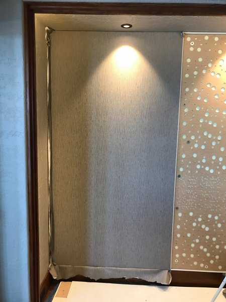

RPG BAD Panels consist of a binary amplitude template attached to a porous absorbing core, typically a rigid fiberglass board. They are essentially a digital and artificial device o_O Do you expect them to help a room to sound natural? ;)
Bonnie’s BAD panels were made on-site using a template she provided. The wall cavities between the studs were filled with “blue jeans” recycled denim cotton insulation, then mass loaded vinyl was applied before the sheetrock was hung. After that, the custom BAD arrangement, covered with a fabric wall.
(Notice the panels have a different drilling pattern of about 18” centered on seated ear height.)
As I walk outside through one of the doors and speak a few words, then come back in I have to admit my voice loses a bit of air and , dare I say, sparkle. In the music room my voice is perhaps a wee-bit richer and warmer. The feeling isn’t one of ‘damped’ per se, and not muted as there doesn’t seem to be loss of volume. That being said, if I use the sound outside as the ‘natural’ reference, in the music room it is not the same.
